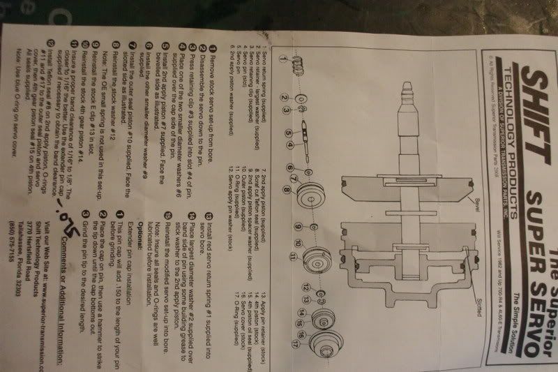

Here's a little information for those wanting to know what a servo installation looks like and details. This is a full 1-2 and 4th billet servo kit from 4l60-e.com aka transmissioncenter.net . I believe these are Fairbanks/Superior brand servos similar to these minus the small blue spring.
Installation instructions, turn your monitor on its side, don't hurt your neck or look like a doofus trying to tilt your head 90 degrees.
