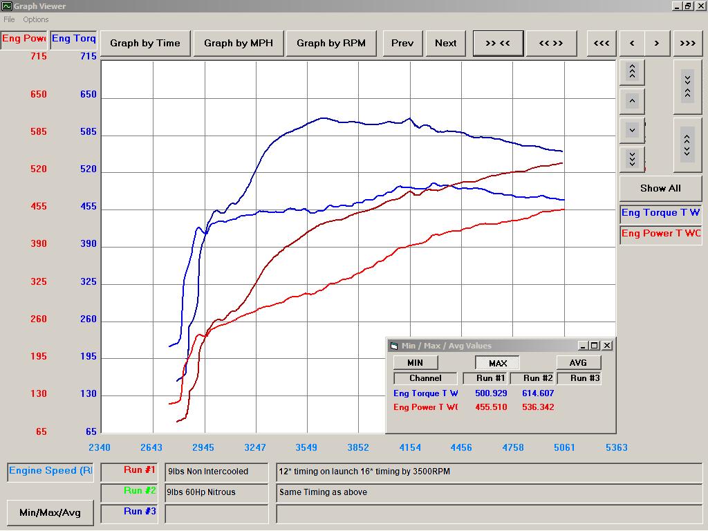

    I have been working on one of the Whippled trucks for a while now in different stages. Long story short, we are running a custom OS SD tune with 2 Bar map, 42lb injectors, drive by wire intake conversion, 9lbs of boost, Whipple electronics disabled and piggy back injectors removed. The boost bypass is the only thing that is still operational as a last ditch safety feature.
    The truck is a stock 5.3 with only a Lunati camshaft. Borla exhaust, Raptor 4l60e w/10" 2600 stall converter.
    Below is a link to some pictures of the setup. I'll post the latest dyno graph with the addition of a 60hp wet nitrous system to cool the intake. The graph on the web page is pretty old and not what the truck is capable now. The web page graph is from the first SD tune and 6lbs of boost if I remeber correclty.
